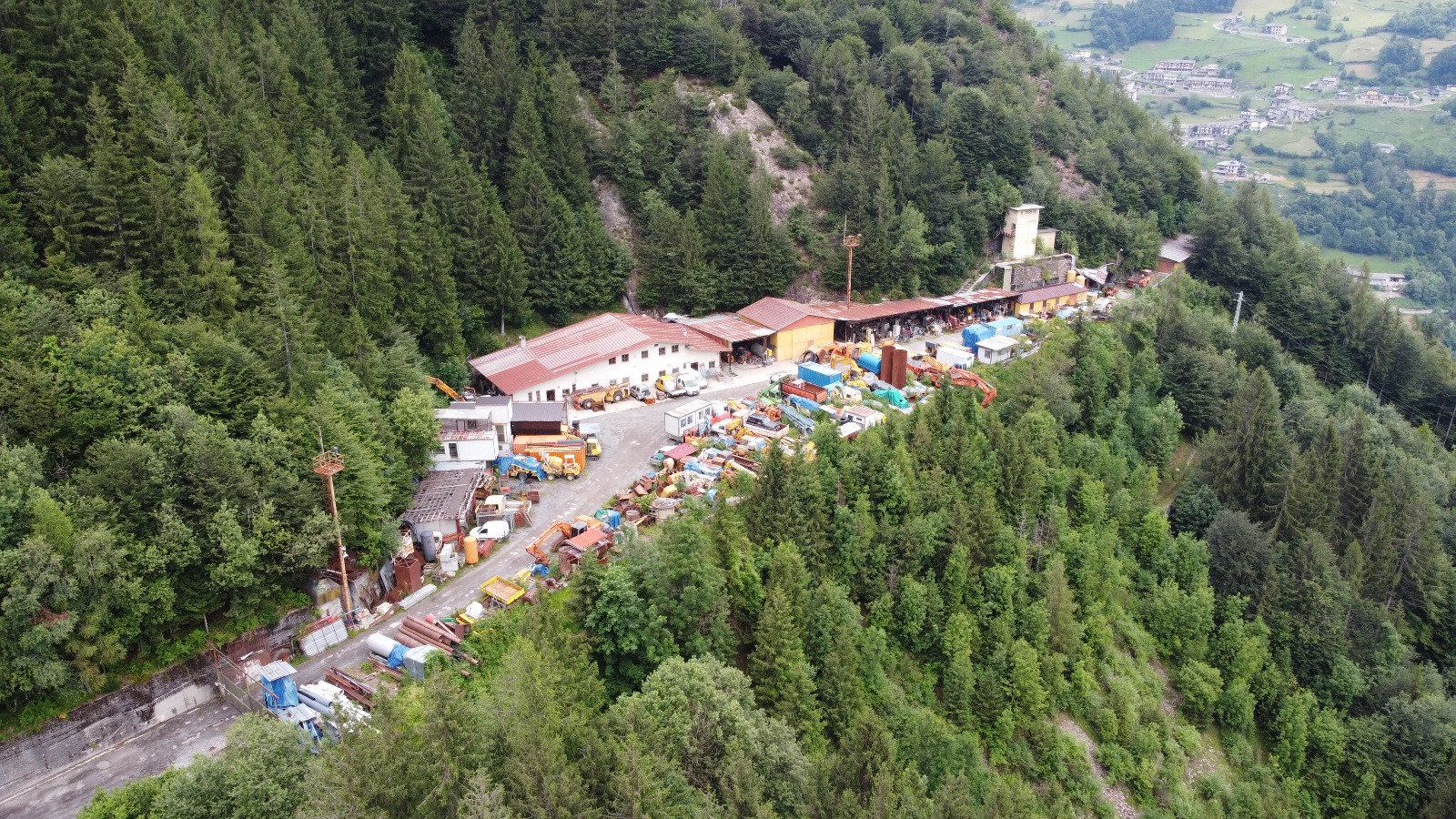

This project stems from my experience in searching for radioactive minerals such as pitchblende, torbernite, and autunite in the field. Deposits of these minerals can be found in Italy, particularly in the Alpine region. For instance, the pitchblende mine in Novazza, located in the Orobie Alps, features waste piles from tunnel excavations that are accessible without significant restrictions. However, these waste piles are situated in the mountains, along steep trekking paths.
This is the Novazza Uranium mine.
Me and other three crazy maniacs digging around...
