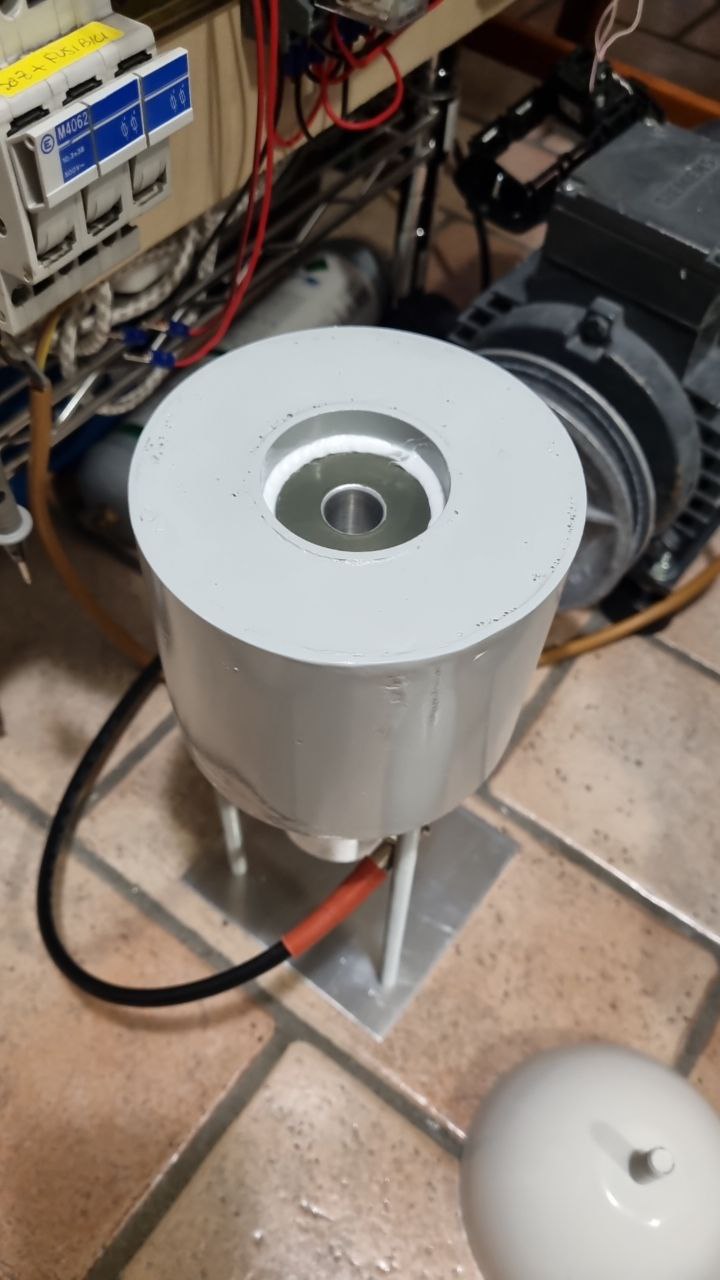

Sahara sand is a normal mess here in Italy at the point I have it cause it mess up my solar panels on the roof, my motorbike and my car. Cs137 in it? Damn I should grab some from the roof and do a test.
I have a 40x50mm 6% welled type detector in 20+kg lead castle.
I will try and report here ASAP
