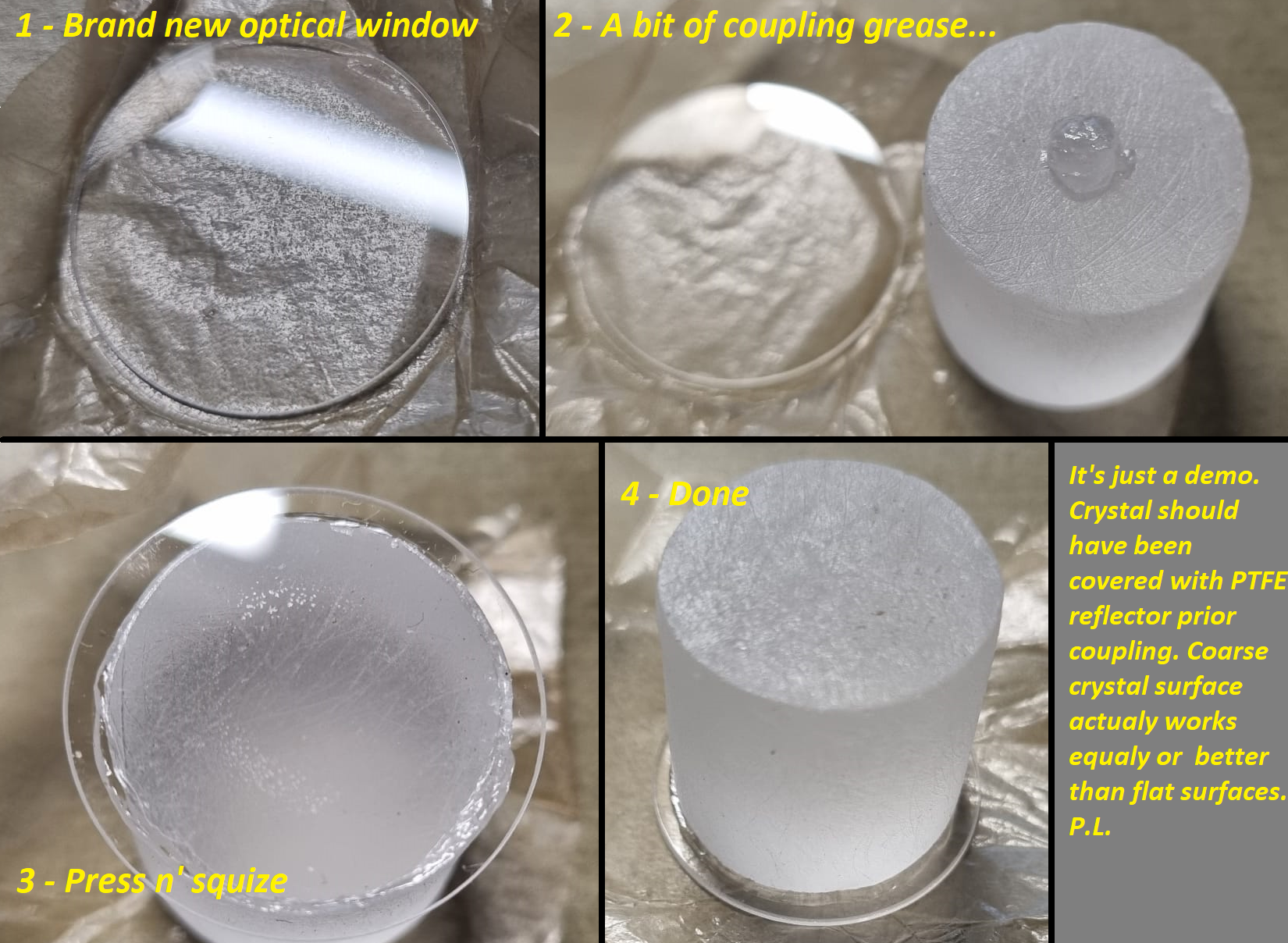

Regarding optical coupling I use two greases: one secretly gived me by him  ;D  and standard silicone grease for high vacuum fittings. I cannot see differences between them in FWHM-%. I don't notice %-FWHM changes if I apply a-shi*load of grease or just enought cause when I press my crystals against PMT window, excess will squize-out on sides.
At my beginning I've used petroleum jelly from drug store and petroleum oil for enologic use wich is rather liquid and still very effective. I've also test also double side tape for optical coupling: 3M VHB kind-of but for optical use. That will glue your crystal.

But is the same thing! Inner coupling of crystal to optical window is the same like the coupling between optical window and PMT. You just need to take care of neutralness of grease used that should not damage the crystal. Usually silicone grease, pure, is my choice. 8)
